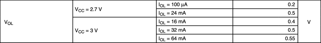

Hm. Indeed. It's a value that can be experimentally obtained, though. If I solidly characterized that value, and it met spec, then I'd have no qualms using that.Running the '245 at 2.85V sounded good at first but apparently the drive strength is not as well specified and may only be 24 mA:View attachment 78211
Too bad they don't have the "0.55V" or "0.6V" spec for Vcc = 2.7V. If they did it might be 48 mA and we'd know this solution would work well.
