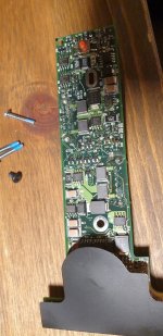

I took the whole thing apart after RAM and CPU reseating exercise. The cap C67 next to the fan is slightly bulging from the top but no leaks. No cracks or burn marks anywhere on the PCBs. The only other part looking suspicious is the power card.

I think there is a bad connector, solder or trace somewhere. I managed to get the chime and screen on once more but after a little shaking screen went black. Power card, sound card or the logic board?
I have a Pismo with exactly the same symptoms... for what it's worth, a sound card/DC-in swap didn't work for me, so maybe it's best to focus on the logic board and power card first. Would be very interested in any progress that you make!

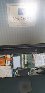

Excellent news. After a countryside weekend I had a new attempt with Pismo. First I had a better look with memory chips and found out I actually had 512MB + 128 MB combo available. Then I wanted to see whether the heatsink makes any difference. Apparently 500MHz CPU doesn't want even to boot  without heatsink. I must have spent too much time with old II series Macintoshes...
So, I put everything together and tightened screws. Now it booted up nice, no chime though. After OS 9 loaded I could verify CPU speed and memory. Now sound worked fine. Then a reboot with chime. Great! As I have plenty of Pismo parts I was able to choose nicer looking plastics and even have all fours bottom rubber pads :-)
The old 6 GB HD had a German OS X 10.1 installed as well so I booted there. Everything seems to work, DVD drive is fine but the biggest surprise was the battery. Two batteries are totally dead and not accepting any charge. But third one reports over two hours on OS X 10.1. I have to try that out whether it really can do two hours on battery power.
