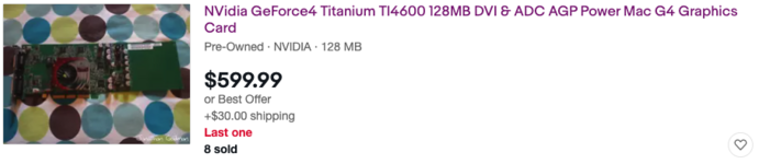

I think you're right, in this case. Not the end of the world, I'm not doing anything terribly GPU-intensive, I just figured since I have this X800 I should try and use it in a computer that I also want to use!
I have the stock 4MX in it now, which is fine, and also works in 9.2.2 which is marginally important, heh. Maybe one day I'll find a 4Ti that isn't $600....
Ouch.
