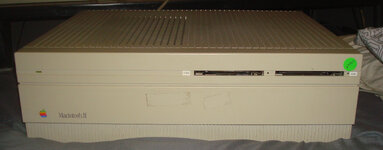

Here's a pic of the Mac II right after I had gotten it fully working but before I cleaned it.
You may notice those little labels next to each disk drive slot, this is one of the reasons I bought this machine! The "FDHD" label told me this machine more than likely had the FDHD upgrade, which it did thankfully! For some reason someone had pulled the FDHD drive so it was missing. I had a broken one on hand I was able to actually fix though so I got that installed and it's working great now. The original 800k drive on the right was still present and cleaned up well.

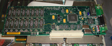

And it came with an Apple High Resolution Video Card, which needed recapping badly. I managed to scrounge up enough caps to get that done, but it still showed lines on the display afterwards. It otherwise worked though. Turns out there was one bad trace going from the F521DW to one of the VRAM chips. Once I patched that, it was working perfectly with no lines!
Before this machine arrived I also ordered one of the original "Toby" video cards too just in case I wasn't able to fix this one, which is actually installed in the machine now. I didn't think to get a pic of it!

Good fix on the video board.
My first Mac II also had the FDHD upgrade. I think it had an upgraded hard drive though, which is too bad because I really like the 5.25" Quantum drives. At least it was better than the Sony SRD-2040 that some models came with (these drives were notorious for stiction).
Thanks! Darn, I swear I had more close-ups of the board, but I can't find them! I'll check it again next time I'm in there for the part number.
Eventually I found a 68851 for mine, so it'll run A/UX.
The FDHD upgrade is so handy to have. I mean, I could live without it but it sure makes things more convenient being able to copy small files over with a modern computer and USB floppy drive. Yeah the Quantum 5.25" drives are really unique. The chunky read/write sound reminds me quite a bit of a Syquest 44MB drive actually. Really like it! And yeah, those Sony 40MB hard drives were JUNK! Funny, because their floppy drives were the polar opposite.
