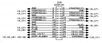

At home I'll be working out a schematic for the display controller itself as best I can. For that I'll need help translating my visual/graphical schematic development into a PCB design schematic.
Panel's controller board appears to be all off the shelf logic and just two layers with all  components opposite the LCD.
I only need to go deeply enough into the controller board so I can see where what goes from the cable.

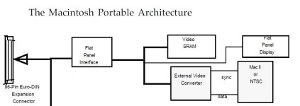

I'm thinking the first step will be developing an interface board driven by Pi or other SBC that'll use the LCD as its display.
Was bouncing this off @bigmessowires and he got me thinking about grabbing the image straight off the video buffer section of a VidCard.

Develop a "Video Card" shield/whatever that will eventually be meshed with the frame buffer of the 306-48 with an SBC using it as a display in that or like manner as that first step.
Adapt the 306-48 baseline design to output Portable res & timings.
Whatever layer may need to be developed between the SBC VidCard shield and the bodged 306-48.
Getting a capable SBC running the M5120 LCD from somewhere within the Portable's case, interfaced with the Portable's Peripherals will be satisfying enough for a bit, but just a bit.  [:)]
