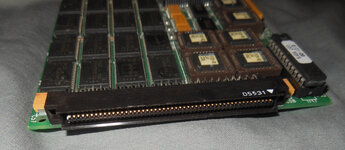

Does anyone know what this card is/goes to?
JT737
I got this off of Ebay a while back in a lot of Mac parts. Judging by the chips that it has I think that it is a video card, but I'm not sure. Does anyone have any idea what this card might go to?
Maybe it doesn't even go to a Mac at all!

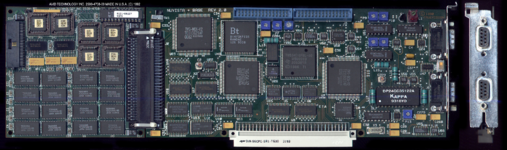

Yes, it does appear to be a daughtercard for the Avid TrueVision NuVista NuBus card, see below.
Now, what that does...I don't know exactly. Video things?
A lot of it seems to be Video memory. It also has the link cable to the JPEG decoder board on it, not sure what the FPGAs (or whatever, presumably programmable, logic chips they are) or GALs are doing, but I'd generally defer to @ppuskari in anything that I think needs his Avid attention.
Oh, if you mean the whole card? They're like, TV studio cards, they usually come with a separate JPEG hardware encoder card (used for video compression / decompression in the fly) and an AudioMedia II. They have video inputs and video outputs and can genlock. They were used in TV studios for titles and credits and other stuff. There is a manual floating around. I believe they can overlay inputted video in a window in the screen, PiP, but I might be talking nonsense.
I have the NuVista, but sadly not the JPEG card, it had gone it's separate way, which seems to be really common with these.
You can just use them as a video card, they support 640x480, the pinout is in the manual.
Obviously the card this thread is about is just a part and no use on its own. Someone unplugged what was effectively two parts of one card.
