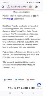

Ah, I realise it says no software for the LC II, the extension is for the original LC. I misread it as no software for the ColorClassic.
