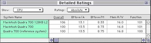

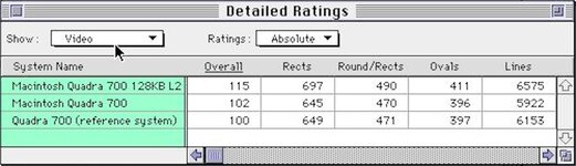

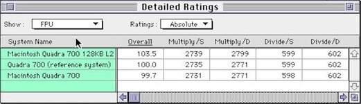

Back on the Q700 doing some baselines in Norton System Info tests before putting the FastCache back in and I’m suddenly getting 10% lower video scores than I did in prior stock baselines… ugh. Apple Personal Diagnostic reports the VRAM test is failing. I do have 6 VRAM expansion SIMMs installed and when I got the system years ago I recall having video issues that resolved with cleaning the VRAM SIMM edge connectors. Guess I’m now working on that again!
Did you reset PRAM on the 700 in between the tests? 24-bit addressing may have been re-enabled and that will impact scores.
I wouldn't be surprised that it's a lot more effective on a 700, as the Wombat memory systems are significantly better so there's less of a bottleneck. The 800 especially has tighter memory timings than the other Wombats to match its 60ns memory.
Sadly I can't find the data sheet for those static RAM chips, but I assume they're 15ns rated based on the label.
Neat benchmarks!
<sheepish grin> After removing all the VRAM SIMMs and testing adding 2 of the 6 expansion SIMMs back at a time they all checked out. That's got to be the mechanical contacts, but the 10% performance drop remained ....and then I saw your post. <forehead smack>. Thanks @jeremywork!

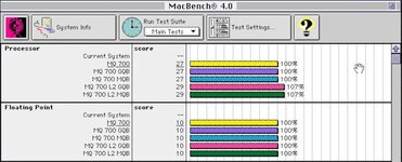

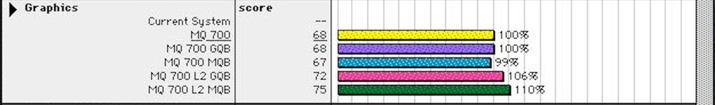

Running MacBench 4.0 now!
For Mac Bench 4.0 I played with the QuadControl control panel "Quadra Boost" ROM in RAM setting, its seems the "MAX" setting (MQB below) provided some increased benefit with the FastCache Quadra over the default "Good" setting (GQB below) but not so much without the card installed.

These results are consistent with what I found earlier this year.
In some specialized situations, such as running a compiler, the L2 cache can boost performance by 30%. But, in most circumstances, it isn't very effective.
It seems like in most cases, the larger 68040 internal L1 cache (compared with the IIci's 68030) was big enough for most classic applications. So, adding a cache card to a 68040 computer just didn't have the same impact as it did on a IIci (or as built in on the IIfx).
There's a hint about this being the case, as my performance testing on 32KB vs 64KB vs 128KB cache cards on a IIci showed little difference.
This suggests that maybe even a '4KB' IIci cache card would have been effective.
There is another possibility. The Macintosh OS has a routine called 'BlockMove' that was often called by the memory manager, OS, and applications. If you move more than 12 bytes of memory, it clears the instruction cache. They introduced a fix in System Update 3.0, but it is 'off' by default in the sense that the calling application needs to set a flag to avoid clearing the cache. This is a long way of saying that the Mac OS may be clearing the instruction cache far too often for even 32KB to make a difference.
On the PowerPC, code is handled differently, so larger caches on those machines would be much more effective.
