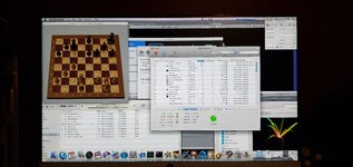

So the issue now is CPU A being around 64C and CPU B in the 50s while CPU A/B intake/exhaust/pump are seemingly in fail safe mode. The temps of CPU A both top out at 74C until the system catches up (the temps of both CPUs increase at the same rate). Prior to today the temps of both CPUs would top out at 65C. When the energy saver is set to "reduced" the temps of both CPUs drop about 10-15C with much reduced fan noise which is normal (temp drop is normal). When the CPU load drops off the temps drop rapidly back to idle (upper 30's-low 40's are normal). What's weird is at max power CPU A is at the "normal" temp (64C) and at idle CPU B is at normal temp (upper 30'sC). CPU A seems to just be about 10C hotter now in general even at idle. For the past year the temps have all been within 4C of each other and drop to the same idle temp.

Attached are some images: 100% usage highest energy setting, 100% usage reduced energy setting, 100% 1 core usage (don't ask it does what it wants) highest energy setting, and idle (CPU B is normal). These were all taken while building from source. As stated earlier the idle temps were reached before I could grab my phone.
