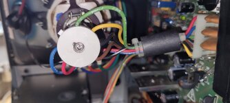

I measured voltages on the lines going to the CRT socket. To make things simple (like me), refer to the attached picture, and I will list voltages by color. All voltage readings were stable on my cheapo multimeter.
Red: 304V
Blue: 149V
Green: -28V
Black with line: ground (goes to CRT frame)
Brown: 0V
Black: 0V
Yellow: 16V
Any further ideas welcome. What is the likelihood that it's the flyback?

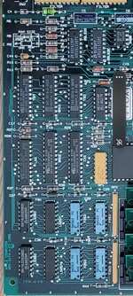

Did you do anything to rule out the problem on the Logic board? Could you upload a hi-res photo around the video circuitry area? (UA8~UG8)
I haven't done anything with the logic board. I attached an image of what I think is the video logic...? Appreciate the help.
