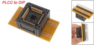

See that adapter? Think about it as a little bit of inspiration.
So, the SWIM chip as we all know is an upgrade to earlier Macintosh SE machines that were equipped with 800k drives and was once an upgrade option for users who want to read and write 1.44MB floppy drives.
I'm now an owner of a battery-acid-victim SE/30 motherboard and was wondering about what could be used as a donor for other systems.  I am also in possession of an 800k Macintosh SE overseas and was just fantasizing about using the SWIM chip and SuperDrive from the SE/30 in the SE.
First problem:  form factor. The IWM and SWIM chip in the Macintosh SE is the 28 pin DIP package. Yeah, good enough. Too bad that the SE/30 SWIM form factor comes in a 44-pin PLCC form factor. (square package with pins on all sides vs. rectangle package with pins only length-wise)
So, looking a little deeper at the documentation referenced below, it seems they are work-alikes, they just need to be wired up properly.
And possibly it may mean that I need to do a bit of board design to get the right pinouts. This is new territory for me, but nothing's impossible, right?
So then the living Mac SE gets the SWIM chip in the bespoke cradle in a DIP package, the SuperDrive from the donated SE/30, and a whole new era of parts salvage possibilities comes about. This feels easier than, say, trying to emulate the behavior of a SWIM chip in a programmable package (using a Teensy or similar that's more powerful than the Mac SE itself.. ha!)
Assuming the board pinouts were routed appropriately and the thing actually works, I'd imagine this would be useful for people doing resto-mods and retro-upgrades to their Macintosh SE machines.  Donor boards for SWIM chips wouldn't be limited to just SE/30's, they could come from Classic logic boards, IIci boards, etc.

Sorry for bumping a really old thread, but have anyone actually tried this? I have a PLCC44 SWIM from a Macintosh IIsi, and I would like to try and hack it onto a DIP28 socket, for use in a Macintosh SE. Maybe we could design a simple adapter board, with a DIP28 layout and a PLCC44 socket?
I made a conversion diagram:

I'll order some sockets and stuff and experiment with this. What I want to do, is to design a single PCB that plugs in to the ROM HI, ROM LO and IWM sockets. It will take a 44-pin SWIM and two 27C010 (or 27C1001) EPROM chips so that you get one solution instead of having to make adapters for both the ROM chips and the new SWIM. However, I have never designed a PCB before, so don't expect this to go well... Will also have to design it in a way where it would fit with an accelerator card installed.
So yeah, using a PLCC44 SWIM from a Macintosh IIsi is confirmed to work on a Macintosh SE with FDHD ROMs.
I initially thought all my work was wasted as I got garbage on boot, but it turned out the chip enable (/G) wire had broke off on the high ROM as you can see in the picture, so I had to solder it back on.
I'm not going to design a PCB for this after all, since the original sockets can't handle thick pins. I replaced the three sockets myself with machine tooled ones.
Nice work! You can get headers with machine pins (round) that should work with the original sockets. I've ordered these before.
I see, but I still don't want to design this PCB after all, since I've never designed a PCB before and it's a lot of work.
At least I have verified that the PLCC44 SWIM variant will work when rewired to DIP28, so that's something.
