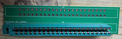

You will need to hacksaw or dremel off one end of the connector, so that it is open at one end. The end result will look somewhat like this.
The closed end can then match up with the speaker end of the logic board, and the connector will come most of the way along the board, and if you've cut it in the right place, will just avoid fouling the hard disc power connector.
Other suitable connectors doubtless exist; just the EDAC catalogue alone is enormous. However, this one appeared to be in stock in all my local distributors, so it at least has the benefit of being available.
