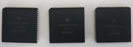

Color Classic won't boot with FPU installed

Just to close this out, I got a 40Mhz one from a seller in the UK and it works perfectly. Seems there are lots of fakes from China on ebay. Seems mad considering how little they must make!
@jimbojones Are you saying that a MC68882 labeled as 40 MHz works with 16? Interesting.
16 MHz doesn't seem plausible at all. Anything made after 1990 is going to be of a mask that'll run at 40 MHz minimum, so who would want or sell 16 MHz FPUs?
I bought and installed a FPU advertised as 16 MHz in 1992 (roughly ~ 100 US$ then) into my original LC (very similar to a CC). I don't know about other manufacturers at that time but speaking about Macs the majority (if not all?) that could be retrofitted with a FPU had 16 to 25 MHz clock speed. Actually I would be happy if my 68882 would work with 20 MHz, I could transplant it into a IIsi.
Faster marked CPUs will always run at lower speeds.

Completely static chip designs can run at any speed, or can even be held in a stopped state. Chip designs with dynamic components (registers, caches, whatever, implemented using capacitors) can only be clocked as slow as the safe minimum speed, but since all Motorola m68020 / m68030 / m68881 / m68882 chips sold at speeds from 16 MHz (or 12 MHz, for the early '020) to 50 MHz, all chips will run safely at 16 MHz without issues.
