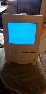

Hello, I'm new here and new to vintage Mac restoration. I bought a Color Classic on Craigslist for $200 that I'd like to get working again. It wouldn't boot, and the display shows retrace lines on an otherwise bright blue screen (see photo). After a good cleaning I found that both the logic and analog boards were in very good shape (no visible corrosion and no bad solder connections). After recapping the logic board, it still wouldn't boot and there was no discernible improvement in the display. I have not yet recapped the analog board. The AB is putting out +5 and +12 volts to the logic board, and the attached infrared image shows that logic board ICs are receiving power.
I'd like to resolve the retrace problem first and could use some advice on how to get started. Turning down the brightness pot doesn't help. Retrace blanking is obviously not working, but from where is that controlled? I don't see an IC on the PCB that's plugged onto the CRT neck, so am I right to assume it's controlled by the video processing (jungle) IC on the the analog board? Any pointers you guys could offer to find the source of the problem would be much appreciated.

Yes, I found the pot, but adjusting it doesn't eliminate the retrace lines unless the screen brightness is reduced to black. It looks like the blanking pulses are missing from the video signal. Would that behavior stem from the video IC on the analog board?
I think the problem with my Color Classic is the logic board, not the analog board. The gray screen with horizontal retrace lines is normal when no video is sent from the logic board. Blanking of the retrace lines is contained in the video data as far as I have been able to determine. In any case I recapped the analog board with no improvement.

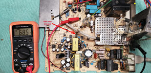

I found a YouTube video that Techknight produced while trouble shooting a CC analog board. He showed how to adjust the B+ voltage level to control the CRT's high voltage. He said that B+ should be about 71 volts to produce ~22,000V at the CRT anode. B+ on my board was only 68.5V which could explain the distorted raster. Unfortunately, the trimpot was glued tight and couldn't be adjusted, so I'll have to replace it with a new 500 ohm pot. To prevent the flyback transformer from producing high voltage, the B+ input to the flyback was removed at jumper J48.
