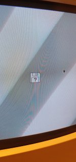

Now the happy mac is showing first and after some time the floppy disk? symbol is on the screen. When the mac starts I can hear the hard disk for short time reading and then it stopps.
I am not sure what exactly the problem is.
File system damaged after hard power off yesterday? Hardware problem after one day?

When this has happened to me (Happy Mac then question mark) it's almost always been an issue with the System file on the hard drive (but not always). Easiest way to fix the issue would be to reinstall system software, and at the minimum I would boot from a Disk Tools disk of some sort to see what's going on. If you have a Windows PC with a floppy drive you can use HFVExplorer to write floppy disks from images.
Ahhh, the Colour Classic is one of my favourites.
This means that it could find the first bit of the code to boot it up but not the second bit, generally.  So either the OS installation on the disc is damaged (as per @JRL above) or the hard disc itself is disintegrating.  If the first time you powered it up it took 15-20mins to boot, that suggests to me that the hard disc might be very unwell and you might need to get a new one.  But try booting from Disk Tools and/or reinstalling the OS first.

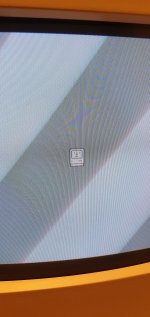

Norton repaired some bad sectors and also repaired a lot of other stuff. The result:
The Machine is running :).
