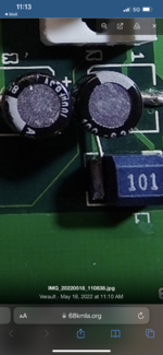

Those pads were damaged so the caps are run to the next trace off the original contact. Those are fine and not the issue.Pretty sure C8 is supposed to connect to that via next to the negative capacitor pad and not where the bodge runs, also what’s the pin touching something here in this area?
