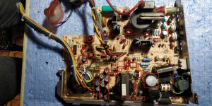

Dear all,
I'm trying to fix this PSU but I got strange voltage, here is the story.
Thorough cleaning
I replaced all the capacitors mentioned by Bruce from Branchus Creations.
the two input cracked filters
I replaced the optocoupler OP1, the TDA4605, the MOSFET IRFB040 and L7912 voltage regulator
Diodes DP1 DP3 DP4
The 2 Zener diodes
I had to recreate a couple of pads that were damages by the electrolytes.
It now shows some life now:
  • green wire is -12.5 volt (OK)
  • BUT orange wire is oscillating from 7.1 to 7.4 (it's supposed to be 5 volt)
  • BUT yellow wire is 19,27 volt, it is supposed to be 12volt
The voltage are stable over time.
What can be the cause, a bad voltage regulator?
I do not know much about electronics
thanks for the help
best
PF
do not worry about the empty spaces for the ICs, they have been added :)

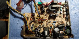

I attach here the picture of the board and all the replaced components
Can someone be of help?
