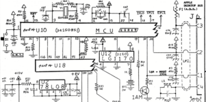

You probably have a bad trace around Egret. It is responsible for generating the reset signal to the rest of the system, and... Well, I know Cuda will only reset the machine if it senses trickle and main 5V are both present. Egret probably doesn't care about trickle, but probably needs to see the PSU 5V rail come up before asserting /RESET.
From Bomarc's eeeh schematics, we want to see if pin 26 has 4.7kOhm to the 5V supply, and if it rises to 5V with the machine turned on. Might wanna check 23 too, that's probably fast reset since it goes to U18. Also check if 12 goes to 5V. Totally forgot U12 is the battery monitor IC. Very important that that works.
