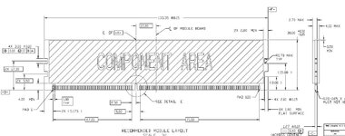

LCIII in Classic poses a brand new problem so I've moved on from PCI Connector to the much tighter pitch, 240 pin DDR2 Memory Module as the LCIII Memory/PDS Subsystem interface which will be running 120 connections up one side of a tall format take on the DDR2 DIMM and back down the other 120 teeth on the edgecard connector..
Was figuring that a notch on one side and a bit of an arc on the other and angled insertion and removal would work:
But KISS principle violation forced me to break out of the Symmetry/Parallelism box constraint. Once outside the box, it pretty much fell into place.

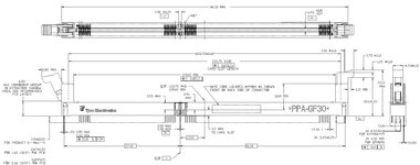

Part II: post was too long, too many pics it would seem: diagrams
Dimm Slot is a much more rigid interface than the MagicalBus PCI /slot/Card proposed in the earlier thread and locked in as well. On the forward side the extractor should be fine I think, but the ear of the backside extractor latch may need to be filed down a bit, if overhead is too limited, but would still remain fully functional I think.
