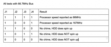

  5. Most importantly, is there a way to obtain a higher bus speed multiplier than 8.0x (see attached picture)?

There's 16 possible multiplier jumpers settings and your chart only shows 11 of those settings. Shouldn't take long to find out what the other 5 do
I feared that I would get this response...
Here's what happens with the other 5 settings:
Is there any way to tell if the processor speed is being reported correctly? I'm just reading from Apple System Profiler in 9.2.2 right now.

Interestingly enough, the two "missing settings" identified by "BDAqua" are the two settings that allow the machine to post, though it seems that they are not getting the results expected -
  • 1,1,1,1 gets 167MHz, which is a 2.5x the Bus, not 9x
  • 1,0,0,1 gets 66.7MHz, which is 1x the bus, not 10x
Is there a way to tell with version of the mother board (1, 2, or 3) I have? I have the version 3 ROM, but it would be nice to know for sure that this is a version 3 board as well, as the post above implies that the motherboard revision is relevant to the multipliers available.

Just retested using Newertech's Gauge Pro. The additional jumper settings may be correct:
  • 1,1,1,1 gets 600MHz, or 9x the bus speed
  • 1,0,0,1 gets 667MHz, or 10x the bus speed
Weird that System Profiler reports a different number, though I've heard it can't be trusted.
Either way, pretty happy that I've been able to squeeze another 133MHz out of this processor. Will need to benchmark further to see if it is a.) stable and b.) actually running at these speeds.
