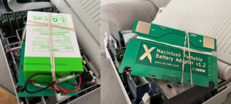

don't bother with a lead acid. use a liFePo4 battery.
look here
Myself, I had a set of these fabricated and then soldered on the tab terminals.
i'm lazy so i didn't 3d print the case.

In the interest of providing alternatives, let me show you a product that has caught my eye:
Just eliminate the whole battery issue, store it for years and then just plug it in and it's fine. No leaking, no reduction in capacity. Ok, I guess those big fat capacitors could eventually leak.
