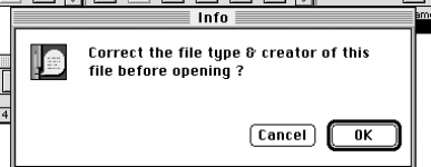

And when I click Open, it asks me if it can change Type and Creator:
That gets the file into the Music List only though.
So clearly, I need to know what is required to make files show up in the Instrument's Open dialog.  Any thoughts?
