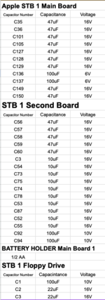

One isn't mine but a friends and caps on that secondary board are bad. Unfortunately I've already recapped this one. The top board is an LC475 standard board only difference is the PDS connector is upside down so pins solder to the top of the board. the secondary board is where all the weirdness is.

Photo is still useful post-recap, I should still be able to label it with the proper values.
