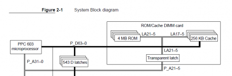

To the cache issue specifically, where does it specify what bus speed the cache runs at? In the dev note, the block diagram shows it being essentially directly connected very closely to the CPU, but doesn't appear to list a speed.
In addition, from page 14 of the dev note:
The 603 bus is connected directly to the main processor and runs at the same clock rate. An external 256 KB second-level cache and 4 MB of ROM attach directly to the 603 data bus and help to optomize system performance.
So, I think that Daniel Taylor is probably correct in saying the 256k cache runs at the full speed of the CPU. Apple certainly thought so, and wrote as much as their dev note.
here is the relevant part of the diagram:
Presuming here that the dark black line labeled P_D63-0 is the 603 bus, the one that runs at 75MHz in the 5200/6200.
