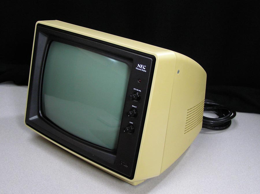

The "right" thing to have sitting on top of this would be a green composite monitor *not* made by Apple. NEC or Amdek would be my first choice. You know, like this:
Aww, but my poor Apple /// monitor :p
If only shipping monitors wasn't so difficult/uncommon. Being able to drive would probably help, I could just make the trip up to RE-PC...
