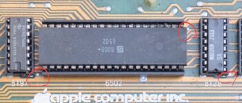

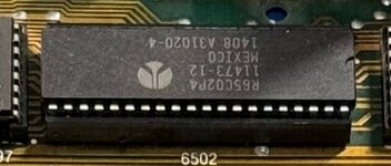

Well, the original manual for the Apple II is showing also the 6502 upside-down.
