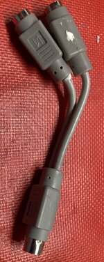

Well I built one and it works great! Could be prettier but I glued the plug together because I did all the soldering forgetting the sleeve first. Wasn’t going to take it apart and start again. Blah.
Thanks for the advice! 🤓
