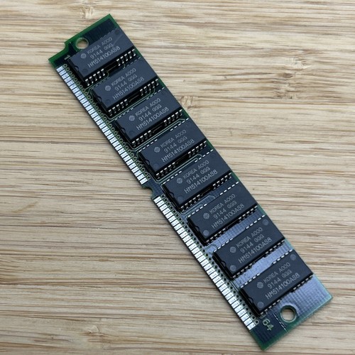

I'm not sure of the basis for the "same as used by the IIfx" anecdote because my 8•24 GC refuses all of the RAM my IIfx happily boots with. I either get no chime/no image, death chime, or outright refusal to power on as if shorted. I eventually got lucky enough on eBay based simply on visual approximation. All of the 64-pin RAM I've seen installed on GWORLD cards is low profile and comprised of four horizontally mounted DRAM packages on each side with central gaps in their pins. Ideally I would've found 80ns to match the onboard, but these two 1MB @100ns are detected in the control panel and haven't caused any noticeable misbehavior.

LEM specifies the GWorld DRam upgrade as being the same as the Mac IIfx ram. However, Apple’s own documentation lists Part Number M0505LL/A as being unique to the GC. if being the same as fx memory, they would have stated that (or maybe not).
In a third party repair manual it is stated that either specific Apple ram or third party ram will work.

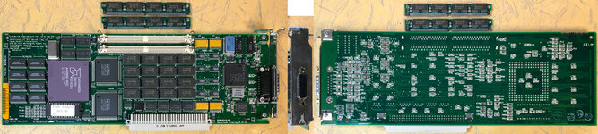

GWORLD RAM was used in other cards, I have these two.

I followed an old tip from @Unknown_K and played the Truevision card lottery, which landed me one with 4x4MB installed. Here's four shots of one of the modules:
@Siliconinsider, hopefully something visible there can help resolve the addressing issue, otherwise pm me and I can arrange to loan/sacrifice you the set, so long as some functional replacement can eventually be derived.
