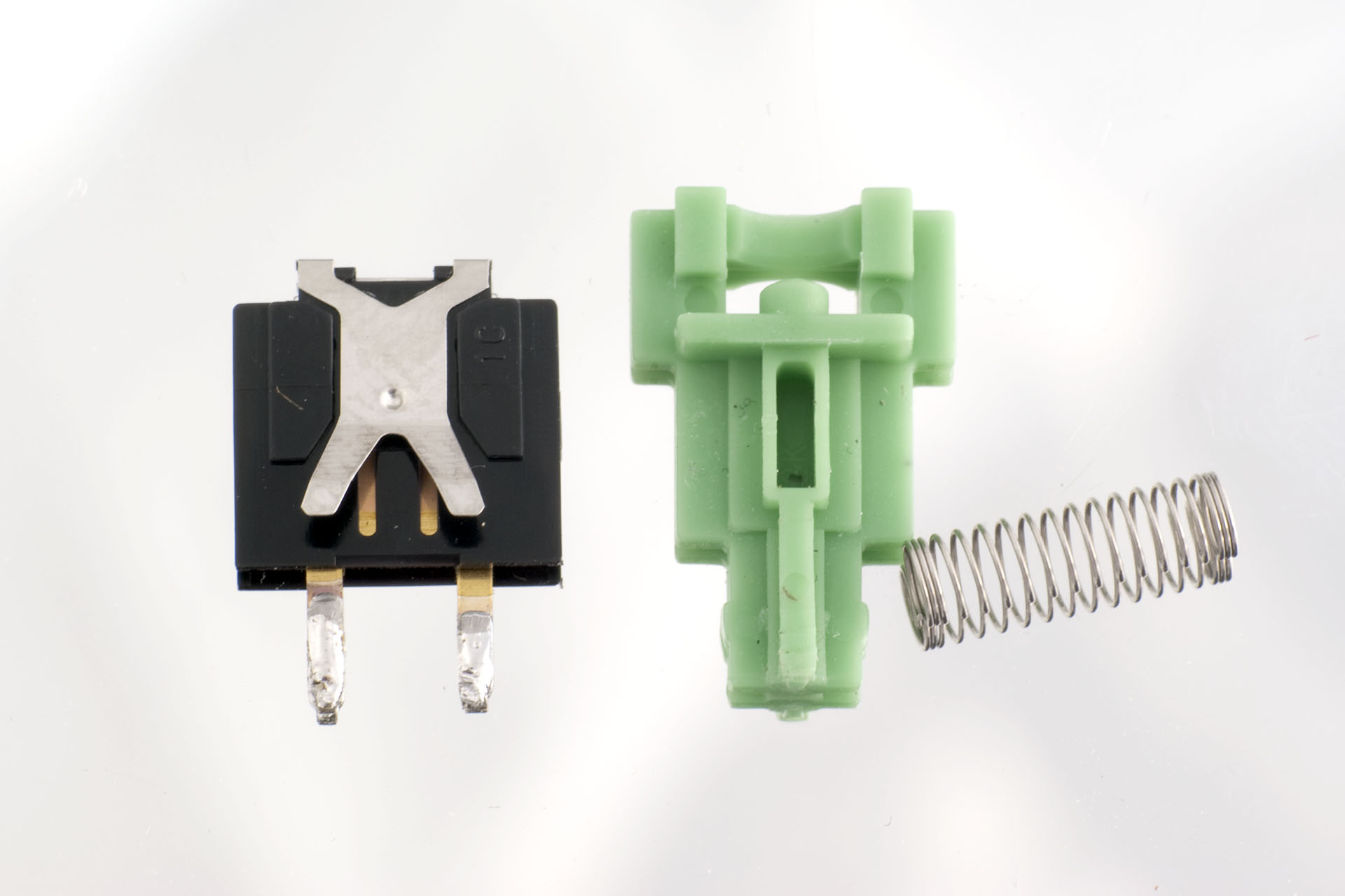

Second picture:
Also, as seen in the above photo, that x-looking part is what the plastic white (or green here) key stem compresses to make the connection. A few of my keys have had the metal compressed too far back (in this photo, away from your screen towards the black backing), and the stem can no longer hit it. Bending the metal legs (the bottom of the x) slightly forward allows the stem to compress it properly and make the connection. In at least three of my
keys that was the only thing wrong.
