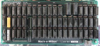

I bought a pallet of old macs from a warehouse sale, and one of the machines was an old 512k with some weird upgrades.
It looks like someone added more RAM and a SCSI port (which was threaded through the external floppy port hole). I can’t tell if this is one upgrade or two.
I’d like to get this little machine working again, but it looks like whoever upgraded this machine made some strange changes to the motherboard, so I’m not sure if they can be undone.
Is anyone familiar with these upgrades?
The RAM upgrade is called Mac’s-a-Million by Sophisticated Circuits.
The SCSI upgrade board seems to be from Relax.
Both are circa 1986, and I haven’t been able to find any info about either company. Is anyone familiar with these, or the companies that made them? I’m not sure if I want to keep the upgrades, so I may just want to disassemble them completely, but I’d like to get more info before I make any decisions.

They could have been bundled together.  The SCSI upgrade looks similar to the later upgrades that came out once the Plus hit the market.  A lot of companies made them.  It essentially turned the 512k into a 512KE by adding Macintosh Plus ROMs and a SCSI controller which (as you noted) snaked out the back.  The ribbon cable out the side could possibly be connected to the RAM card to give it Direct Memory Access for faster SCSI transfers.
Since it had the Plus ROMs, the RAM upgrade could have been anywhere between 512K to 3.5MB (giving you a total of between 1MB and 4MB.)
That is a 2 MB RAM upgrade. That board has 48x256kbit DRAMs on it, 1.5MB there, meaning your 512K will have a total of 2 MB of RAM. Coupled with the SCSI daughter board and the 800K drive which I see is installed, you now effectively have a Macintosh Plus, and you can run System 7 if you want.
I would keep this upgrade, by the way. It's far much more trouble to downgrade this machine that you now have back to a stock 512K.... Unless you already have these parts on hand: You'd need to get the old 64K ROMs, plus the 400K drive and its mounting bracket. Easier to get a stock 512K.
