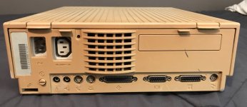

I also have one question, the power button on the back can be turned and locked, what exactly is the purpose of this? Sorry if that’s a dumb question, but I’m brand new to the IIsi.
Forgot to add that it's mainly useful in server-type environments where you want it to reboot automatically after a power outage (this was before smarter ATX-like power supplies and computers (Mac and PC alike) could do this via software).
