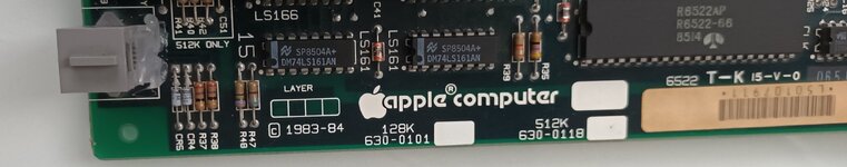

The RAM upgrade board shown in the picture its a MacSnap 2048, fully populated. Meaning it should bring 1.5 MB more to the system. On a 512K/Ke, total memory with this board should be 2 MB.

The original Macintosh 128K came with PCB revisions 820-0086-C/F (630-0101).
PCB revisions 820-0086-C/F differ from 820-0141-A in that the latter has an additional 74253 IC to generate the RA8 signal when 256Kb ICs are installed (512KB of RAM). Jumper W1 on the 820-0141-A board should be bridged if the logic board revision is 630-0101 (Mac 128K) and open if it's a 630-0118 (Mac 512K).
Here is a picture showing where the "PCB revision" model's location is on the back.
And here is a picture showing where the "LB revision" model's location is on the front. For a PCB rev 820-8141-A could be either a Macintosh 128K (630-0101) or a 512K/Ke (630-0118)
If you are trying to obtain an original stock 128K logic board, an unmodified 820-0086-C/630-0101 is what you are looking for
According to the serial number shown in the picture, your machine is a Macintosh 128K with the hybrid PCB revision 820-0141-A. Meaning, it can be reversed to its original state without changing the whole LB.
However, you will need to do a few things, with one being a little complex if you are not skilled with desoldering:
1. Unplug the MacSnap Board (Super easy, nothing should be soldered. The board "snap-in" into several ICs and is fully removable)
2. Find the original 64KB ROMs, maybe on eBay or someone on the community willing to sell them to you.
3. Swap the sixteen memory ICs back to 64Kb from 256Kb. That can be only done by someone truly skilled to avoid damage to the LB.
4. Bridge W1 after the swapping.
5. Find a fully working 400K Floppy drive, which become scarce and expensive lately.
