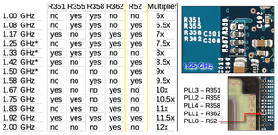

A question for those that may have one of these specific, stock G4 Mac minis.
1.33 GHz Mac Mini ONLY
Q: Is there a resistor present at the R52 location (under the heatsink)?
Resistor location red-dotted here on a 1.25 GHz Mac mini.

Wasn't the "1.33GHz Mini" the silent upgrade version of the low end model (1.25GHz)? R52 is just one of the PLL resistor inputs to the CPU. If you're trying to change the CPU speed, you can check the datasheet or one of the overclocking guides around. Would any Mini set for 1.33GHz be a "1.33GHz Mini?"

The 1.33 GHz model AND the 1.5 GHz are members of the 10,2 Family - while the 1.25 & 1.42 GHz were from the earlier 10,1 Family. The 1.5 GHz model featured the increased VRAM of 64 MB (over all others @ 32 MB VRAM).
And my inquiry here (and elsewhere) pertains primarily to many of those oveclocking guides that you mention and as to whether or not the stock 1.33 GHz version was originally produced without the R52 resistor... that those guides note need be removed to attain 1.33 GHz. Now, that might be because the guides apply primarily to the 10,1 family… but that is partially what I am also attempting to clarify. *One might note too that the settings for many of the overclock speeds above 1.58 GHz also note the removal of R52?
(Perhaps in a related vein, in order to downclock a 1.42 GHz mini to 1.33 GHz - would one need to remove the R52, R351 and R355?)
Inset images below are from a 1.25 GHz G4 Mac mini.

I happen to have a 1.33Ghz mini sitting on my desk awaiting reassembly and can confirm R52 is not fitted
As a odd aside this mini is badged as a 1.25Ghz unit but is actually a 1.33Ghz one, I wonder if this was a case of apple using old stock shells or of this had a in warranty MLB replacement and got the faster board (It 100% hasn't been modified, I know where this specific mini came from and the original owner definitely did not overclock it)

The G4 Mini uses a 7447 CPU and has a 167MHz bus speed. The CPU speed is a multiple of the bus speed, so any Mini with a 1.33GHz CPU will have the PLL resistors configured a certain way. Check the 7447 datasheet for possible PLL settings and the overclocking guides for which resistors correspond to the PLL inputs.

The chart posted above only shows half of the resistor positions for the Mini. For example, I think it would be technically more accurate to move R52, instead of disconnecting it.
