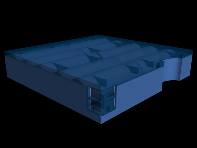

This is a recreation of the Apple PowerBook 1xx battery housing so that new battery packs can be made up for the original PowerBook line. This model is the culmination of weeks of work experimenting with multiple iterations of the design to have one that works reasonably well. While it is not...
