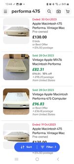

People are selling whole 475’s for upwards of $500 on eBay… cheapest 475 motherboard on there is $140 and it’s crap. Whereas there are a few real 68LC040’s on eBay for $20.

My bad, I was searching for a "Mac LC 475"
