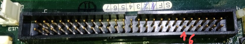

Hello, I have a BlueSCSI rev1.1a installed on the internal port on a Performa 475. I installed it with several images and everything works fine. But I leave the Performa without using it for a few weeks, with the battery full, and then it does not recognize any BlueSCSI boot disk, instead I disconnect it and connect another 25 pin BlueSCSI to the external port with the same SD and it starts from there. I try it many times and in the end without knowing how, it starts. But I turn it off and store it for another season and the same thing happens again.
Do I have something configured wrong?

Do other SCSI devices work internally? I also had to repair one of the data lines to get my internal 50-pin working on the 475.
I thank you very much for the indication, you were right. I tried a SCSI HD and it didn't work either. I looked at the tracks and they all looked good! I couldn't find anything, but I couldn't find where PIN 12 of the connector (DATA BUS 5) went. I have a broken 475 motherboard, and I checked where it was going. Well, that track had continuity from the chip until it reached the plastic of the connector, but not in the connector! It turns out that the track is damaged just under the plastic, I guess it broke from plugging-unplugging the cable. With a cable I connected from there to the bottom of the connector and it works again!!!
THANK YOU VERY MUCH TO ALL!!
As a precaution I have added a piece of eraser under the PCB, under the connector, to prevent it from bending when plugging and unplugging.
My Performa 475 has come back to life!
