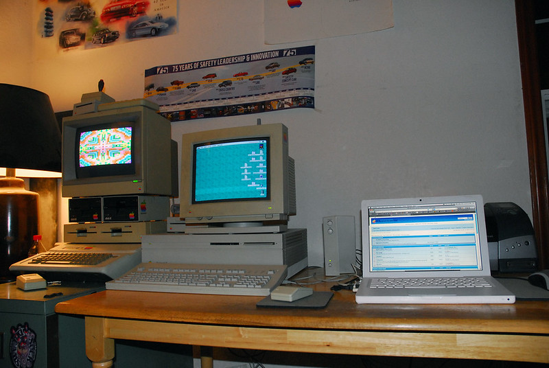

3 guesses where my IIe card lives... :) Oh, and that Trinitron rocks! :cool:
