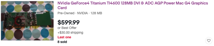

I have the stock 4MX in it now, which is fine, and also works in 9.2.2 which is marginally important, heh. Maybe one day I'll find a 4Ti that isn't $600....
Ouch.
Doing a quick search for "nvidia geforce4 titanium ti4600 128mb mac" and specifying sold items I came up with three of these that have sold for around $200-ish since mid-July.
