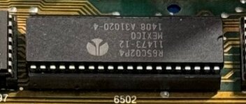

Just a wild question... is the 6502 the right way 'round? Seems kinda odd it's oriented 'upside down' compared to the EPROM at the bottom...

Yeah, the CPU matches the silk screen on the board and the one that was in there when I got it.

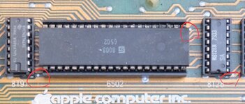

Umm... but it's not working, and hasn't right? I found another Rev 7 Apple II board, and its CPU is rotated 180° :

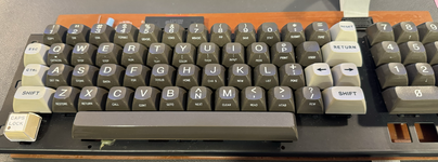

As for the clone, it appears I have a clone case that had an original board in it. The keyboard has a numpad on it, and the main keyboard keys have commands on the front of them. It doesn't have an Apple (command?) key, which made me think it was more likely an Apple II vs a IIe. The power supply is a Peak Power KHP 4007. The original owner had replaced at least a couple of the RAM chips, as the three tows did not match and the second row also had two chips that didn't match.
Looks like I have a Rev7 board that has a different orientation, like this one: https://www.reactivemicro.com/product/apple-ii-plus-rev-7-rfi-motherboard/ and here: http://appleclub.pl/wp-content/uploads/2018/04/IMG_0619-1.jpg
Or the CPU in your image is actually installed backwards. Just to check, I did try the "non-working" CPU with the orientation set to the way it is in your picture and it did not work. I got a blank white screen.

Keyboard is not original, probably a clone.
No Apple II had a numeric keypad, only the platinum had one.
How totally confusing! The second pic you linked does show "dots" near the chip corners which likely indicates PIN 1 position:
These do appear to coincide with your board, so I guess you're all good. Still... annoyingly confusing!

Well, the original manual for the Apple II is showing also the 6502 upside-down.
