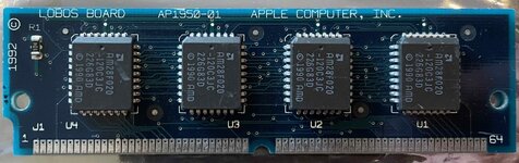

There is an empty white slot on the center of the motherboard, labelled "ROM SIMM". Is that rom missing ? Can the IIci work with this slot empty ?

<< If it makes a chime on startup, it has found a ROM. >>
Oh yes, that's simple I should have thought about it.
<< The IIci has a jumper at W1 that enables the built-in ROM. >>
That's right, I can see the jumper.

If it makes a chime on startup, it has found a ROM. The IIci has a jumper at W1 that enables the built-in ROM.

Jumper the two-pin header at W1 near grid reference A8 on the MLB, unless you have one of the just-in-case separate ROM SIMM cards in the ROM slot. If there is one of the fabled ROM cards, leave the jumper off the header at W1.
