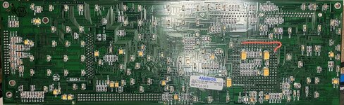

I have finished my journey with the Orange PC 2 hardware upgrades and everything is working great! For those just tuning in, my card started life as a "220" with only serial/parallel. I added L2 cache and PCMCIA to give it all of the features of a "290". I even got write back cache working on my Am5x86 at 4x by moving the bodge wire to always enable it. Running at 160MHz with WB enabled, I scored a 60 on Speedsys. I also got Windows 95 installed and running stable on this configuration. PCMCIA works within Windows 95 as well! Below are some photos of my modded card. I put an oversized heatsink on the 3.3v regulator as it does get quite hot. I had to cut a fin off of the heatsink to make it fit. I also trimmed back the PCMCIA cage to make room for socketing the Decl ROM after I dumped it.

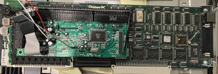

I've also finished modding my original Orange PC. The clock doubling and 8k of cache works perfectly on the TI486SXLC2 I installed. I tried overclocking it, but the OrangePC application reports errors on start even when I run it at 30MHz, so this card is basically not over-clockable. The 25MHz (50MHz clock doubled) speed and additional cache still result in almost 2x performance vs the Cx486SLC that came installed in the card. Speedsys locks up with this configuration, but SI8 and Topbench report scores between a 386DX-40 and 486DX-33. I also used an ISA riser card to install a low profile sound card which I wired up to my Quadra's CD audio input and it also works perfectly! I really like the audio quality and the fact that line level audio is exposed on headers for the OPTi 82C931 card I'm using, but loading the drivers do make MS-DOS 6.22 take 5-10 minutes to boot... If anyone else tries this, I'd recommend using a different ISA riser than I used. The "riser" I used was designed for pin headers, not another ISA slot; so tedious bending of pins on the edge connector slots was required to make it fit. You can't see in the photo as it is below the sound card, but I also attached a heatsink to the CPU as it gets quite warm vs the original.

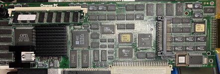

I also took some better quality photos of these Orange386 and OrangePC 290 cards.
Is the above Orange386 card from the OrangePC 200 series?
I assume it's a Nubus card. The question is where the Nubus interface is implemented. I see a Xilinx FPGA (U44) and a large IC right above it (U67). Unfortunately, the sticker "90 ATC 01020" hides the chip markings. It would be great to know what kind of chip sits there.
Every Nubus card requires a DeclROM to be recognized by Mac OS. U82 looks like the DeclROM. Did you try to dump its content?
On your card and CPU did WB give a reported boost over WT cache? I've a OrangePC 290 card with an Intel DX4-100, unsure if the WB-enabled version but keen to try if worth the effort.

Yes, it did provide an increase in benchmark scores. The speedsys CPU score increased by 5-10 points and the "move" memory test was significantly faster. A DX4 with WB should be enabled by default on a 290 if it is set to 3x multiplier and has the bodge wire on the back of the CPU socket. If the wire is missing, you can add one in the location it is placed in my photos to enable it for all CPUs that support it (not sure if this causes problems for CPUs that don't). If your 486 supports WB it will have an "&EW" etched into it, the WT models just have "&E".

I wonder what function the Xilinx FPGA (U44) implements. Judging by its position it does something related to the Nubus interface.
The XC3000 datasheet tells us that XC3042 is a FPGA. That means that it needs a configuration program stored in a EEPROM/SROM to be operational.
Do you have any idea where its configuration is stored? It's often a specialized SROM in a small 8-pin package.
Anyway, it would be great to find that ROM and dump its content like it was done for a Digidesign Nubus card, see here
What kind of IC is U57? I can't see its markings because of the sticker on it.

The other QFP100 chip obscured by the sticker is an Actel A1020. I think those are antifuse devices so it's holding its own configuration.
Then there's two GAL-like PEEL devices and an AMD MACH CPLD.

I suppose there is no way to read out A1020 configuration without decapping the chip and doing some time and cost consuming IC RE.
Do you have a list of ICs used in the Orange PC 200 cards handy?
Everything I got so far are two high-resolution pictures of two boards.
The markings of some ICs aren't readable though.
My cards are packed away in boxes for moving right now. But if you can't get part numbers from others, I should be able to get them within a month or so.
