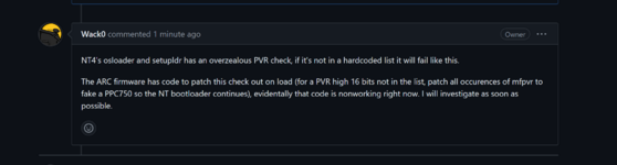

Has anyone tried running this on a G4? The Github suggests that NT4 should be okay with a G4 CPU but my experience says otherwise...possibly when trying to do this on my G4-upgraded B&W.
Sadly I don't have the original CPU to test with. :c
This shows up almost immediately when the text-based setup starts. There's no attempt of it loading up the drivers etc.
Okay, developer has confirmed it's a bug with the pvr check in the patch that ARC firmware uses to fool NT4's osloader to being chill with the machine, guess it impacts G4's specifically. They're working on fixing it!

This is kind of cool, and I do have a Power Mac G3 B&W, but I have a G4 installed, so it might not work with that without putting the old CPU back in.
Someone should try to get AIX working on these Power Macs.
It should work with the G4. The ARC firmware does patch the processor check in NT4's bootloader. I already received and fixed a bug report about that, and someone did get it to boot in a G4-upgraded Yosemite after that.
