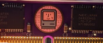

There is a modern Ethernet card for the SE/30, the SEthernet/30. I have reworked my own version for the IIsi (see here).
I expect it wouldn't be very hard to do a LCIII/LC475 version. The slot is physically wired completely differently, but logically all the MC68030 signals are there so it's just a matter of doing the PCB.
