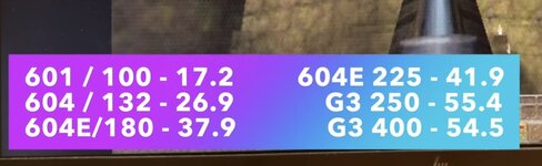

I did a lot of Quake benchmarks on six different CPUs in my PM7600. Rage 128 out of a B&W G3 for video so the CPU wasn’t bottlenecked, and 256MB of memory on Mac OS 8.6. This is 640x480 in GLQuake.
Lots of other testing too if anyone is curious.
Edit: just saw this is the NuBus forum sorry.
Don't worry about the NuBus thing, all numbers are good numbers 😆 Crazy result with the G3/250 vs G3/400, wonder why it hits a brick wall like that!
In the video I linked I said I thought it might be the Rage 128 but the more I think about it the more I blame RAM bandwidth. I have a B&W G3, a 6500, and a Sawtooth G4 that also all run at 400MHz and it’s something I plan to test in the next video whenever I get time.
