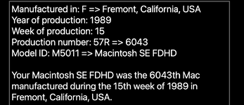

moment I got it I checked serial number and it showed as a fdhd I was hyped hyped since I dint need social 800k floppies and could just make myself a install floppies.... F91557RM5011 showed as late 1989 Mac SE so I assumed it was a FDHD

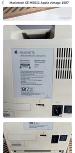

I have seen another SE for sale, the main rear label says 800k drive, 1 Mb and 20sc hard drive, while the small sticker has a M5011 serial number.
Front is just the usual SE label.
Don’t know what to think about it, maybe at some point all were 5011, with or without the new drive and Roms ?

The SE went over to FDHD/SuperDrive in August 1989. Your SE is from the 15th week of 1989, so you're about 15 weeks too early (possibly less depending on when the SE FDHD began rolling off the assembly line).
