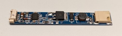

I recently overclocked my Clamshell's CPU to run at 400MHz (and the bus at 100MHz), and the ~20% speed boost means it's now barely fast enough to use on a few parts of the internet. I had to take a picture of it displaying this same thread on the 68kMLA forum. :)
The backlight modifications I made seem to be holding up well so far, albeit with the quirks described above. I decided to remove the transistor I added to the LED controller board, but there has been no negative change in functionality. The laptop has been running for many hours without issues. I did need to replace the supercapacitor on the logic board, as I was having some PMU-related problems, but this was more of a general maintenance task than an LED mod-related one. Next up: finish the battery pack rebuild project I started a few years ago (this time with greater safety and functionality.)

Success! I just did the LED backlight mod on the IBM panel in this Tangerine iBook, and wow, it’s bright! WAY brighter than my XGA-modded Indigo, and as bright as my M2 MacBook!
I did not need to shim the backlight, I simply used the rubber that previously held the CFL and it fit perfectly. The backlighting is even and did I mention it’s bright?!
As expected, brightness control was backwards out of the gate, so I did the trace cuts with a nice wide cut and added the wire bodge. I have the same quirks, using the brightness buttons in Mac OS X results in:
  • 1-4 are dim but brightness does increase slightly
  • 5 is medium brightness, but the screen is flickery
  • 6-8 are almost full brightness
  • 9 is dim
  • 10-11 are very dim
  • 12 is almost full brightness
  • 13-16 are full brightness
I do see flickering sometimes after waking from sleep at anything but 13-16, so that’s interesting.
I did notice that touching the board tweaks the brightness a little. I wonder if we can put a resistor on the signal wire or something to make it behave as expected… In the meantime, this looks amazing, thanks documenting your efforts and the fix for inverted brightness!

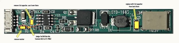

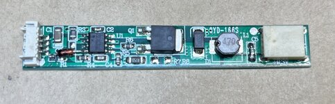

hey team, i spent a while really digging though the DF6113 and figured out another idea for a mod. I have used it in several powerbooks that had the "inverted output" problem, and so far it works great. I am not smart enough to explain it... i just kept pushing around data sheet, dismantled a couple controller boards, used google translate to dig through a russian guy's website, and then just started pulling off caps and bodging parts around. This mod is purely to the board, no other wiring tricks or anything; i have tried it with the blue boards, too, the components have different IDs but their location is almost identical.
here is the mod i devised, plus a movie showing the success. (the iphone auto-adjusts the brightness, but i think its still apparent.)
let me know if you try it yourself:MODS.jpeg good luck and godspeed.
Great work! I'll have to play around with this at some point!
Two questions: Does this version of the mod fix the issue where the brightness gets sort of "jumpy" as you go between the levels?
I remember my mod idea from 2021 wasn't perfect because the brightness would sometimes increase even when the decrease brightness key was pressed.
The only catch is that the dimming adjustment is not constant for some reason: halfway through adjusting the dimming slider, the screen gets brighter again, but by the end, it goes dim.
Also, does this fix the issue that @lazd described where touching the board would make the brightness twitch? I remember having that issue myself as well.
the brightness goes smooth up and down, with no jumps or regressions, just up-down brighter-darker.
i manhandled the boards vigorously (wire, start iBook, good, shutdown, mount board, start iBook, good, shutdown) and never encountered any twitchiness.
Fantastic! I look forward to trying this out!
I gave this mod a try today on a board with blue PCB and am happy to report it works perfectly! Brightness steps smoothly in the correct direction between dark and light with no jumps or dark spots like before. Bravo for figuring it out, @AEChadwick, thank you for sharing!
@davidg5678 I didn't try poking it while it was connected this time, but once it's all nicely mounted into the lid with double sided tape, I haven't noticed any flickering.

I just took my old LED driver board mod apart and reconfigured it to match the plans posted by @AEChadwick. So far, so good! It all seems to be working perfectly --much better than the previous mod revision, with seemingly none of the old drawbacks. A big thank you to @AEChadwick for sharing all of the LED backlight experiments they have been working on this past year!

I haven't had stability issues once switching to the latest revision of this mod described by @AEChadwick. I believe @lazd has also had good results as well, but hopefully he can describe his long-term experiences as well.

i have done (5) iBooks of a couple different generations; i don't use them everyday, but every time i use them they are solid and bright: no drift, no flicker. It's been a great mod for my interests. I cannot report how they run off a battery, and i would be interested to hear about that.
