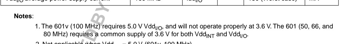

Curious, though - I checked through the 601 datasheet and found the following blurb. I'd assume you're running VDDio at the same as the core since earlier boards probably used the same supply for each... seems like this could be a potential problem. But it might just be motorola covering their rear for the conditions they're willing to specify 100mhz operation at.

I'm pretty sure the part of the mod where you move around a bunch of large 0 ohm shunt resistors switches the I/O supply from 3.6V from the regulator to 5V from the PDS since the 601v uses 5v for I/O. I haven't confirmed this myself though. Anyway, I already have a 100MHz card, and can confirm that after the mod is complete, the above instructions will make a 66MHz card identical to a 100MHz one, so either way I think it's fine.

Oh, the original cards also used a 601v on the 100mhz version? I admit I'm not up on much of the PPC stuff. It makes sense then that they'd have a bunch of shunts to change the IO voltages then.
If I remember correctly, there wasn't a 601 @ 100MHz. Required a change to 601v.
