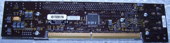

I installed several NewerTech cards in 7100s when they were released.
The problem with this card is that the ribbon is soldered to the card and much stiffer (and shorter) than the Sonneth card.
After several manipulations, they all ended up breaking and impossible to use an HPV card. I think that's why we do not find much.
NewerTech card with soldered ribbon :

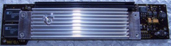

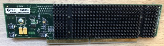

Sonnet card with the ribbon attached to a connector :
I have a 7100 with a Sonnet G3 / 300 and HPV card and another with a NewerTech G3 / 240 with a Nubus video card (because some lines are cut on the ribbon, I cannot use HPV card).
The NewerTech dashboard allows you to set only the Level 2 Cache:

The purple heatsink is pretty much a brand indicator for Sonnet. Don't recall seeing one with any other color. Date on the PCB a/o pics of your card would be helpful.
I got a box lot of NewerTech G3 cards quite a while back. Couple of low profile boards and several taller boards with the passthru cable, some with slot kits and vidcards. More than half the cables tested good, but some didn't.
Sonnet's optional, longer active component cable seems a much more robust implementation than the short, passive NewerTech implementation.

Sonnet offered the same card (with a G3 or G4) for the 6100/7100/8100 with HPV or without.

Interesting, I've never seen one with a black heatsink, all my Sonnet accelerators have the purple type. Of these boards, I only have the lower profile heatsink with passthru implemented.What's the date on your card 30th week of 98?
Never heard they made/released the G4 version for the NuBus PDS either. My G3/400/1M box from the day says "Crescendo/NuBus G3 or G4"plain as day but I've never seen nor heard of a G4 in the wild. Now my 81/110 feels left out. I imagine that if it had been released we'd have heard of it and the TAM gang would have been bidding them into the Ionosphere.
