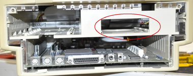

Might be a silly question to bring up but I can't find any information on this:
I noticed my 520 and 575 chasis has what appears to be an unused bay? It may not be for an ext video connection because they never made a face plate mold for it...(all the other chassis that supported add-on ext video connections at least had one with a plastic punch-out of some kind)
Not even the Macintosh TV chassis uses this for anything...I'm thinking maybe an extra fan went here? Not sure. Anyone else here know if/what Apple ever used for this or if any third party hardware makers ever made use of this bay?

It's for the Radio and TV antenna modules. Fits everything from the Performa 630 to the 6500. Most are just UHF, the following is a UHF +FM version.
Really? I checked Macintosh TV photos and it didn't use this bay for it's TV hardware. (Macintosh TV is a modified LC 520 board from what I've read)
Does seem like the PCB would align with the side rails but the chassis lacks the screw holes the face plate has.

I didn't mention the Macintosh TV, this is for Performas.
Different location, but this is the same thing in my P5400 :
I see. I just bring up the Macintosh TV because it was the only chassis of the 5xx line I knew had TV related hardware in it so I had previously checked to see if it put anything there.
Oh your photo just loaded for me. Very interesting. It appears the main card this connects to uses the LC Comm slot...so only the LC 575 mobo is configured to take one of these. The question is if a faceplate was made for this because my 575's rear plate does not have a cutout for this. Curious if this is one of the few LC Comm slot cards that could be used along side the Apple IIe card. I hear due to how that card works, most LC comm slot cards can't be used along side it. :(
EDIT: Checked and the main card's composite inputs would not align/fit with the cutout the default faceplate uses for the comm slot expansion area. infact I'm not sure if the exterior chassis could even fit it because it looks like they'd hit up against the side wall in that orientation. Unless they made a card that was RF only?

Oh I see. That's the TV personality add-on. I think that's what this one is. Is not an LC Comm slot device if I recall right. (you can see in that photo the LC comm slot in that 630 off to the very right). Unless the 630 had two LC Comm slots, this is something the 575 mobos can't take. :(
It's possible Apple planned one for the 5xx line but decided to instead make the Macintosh TV and just never made a module/card for it. :(
I don't think it would work in machine that doesn't have the weird AV slot on the right hand side (from the front) though. I believe it uses hardware on the AV card. That would mean it wouldn't work on the 575 / 520.

My educated guess is that they planned the tuner/AV cards for the 520 series of desktop Macs, but it wasn't ready in time, so that bay was never utilised. They then decided they'd just wait until the 5200 was ready as it'd meet more stringent requirements for tilting the device.
For clarity, they plug into the main loom in the machine and to the main edge connector from there. The little box with the TV and optionally radio antenna connectors don't plug directly into the logic board or AV card, but you need the AV card because it has video hardware chips on it.

I’m a bit confused, OP was asking about the LC5x0 series. I’m not seeing the connection to the 630/5xx0/6xx0 series.
Although its function isn’t clear, it seems like the bay being asked about has nothing to do with a TV tuner.

The physical opening in the case is for that module, even if the computer electrically doesn't support it.
Someone over at the Vintage Apple Macintosh Facebook group tried and confirmed the RF module does not physically fit into this slot:
I had asked about this there as well. The mystery continues. No one there seems to know what this bay was intended for either.
If they intended it for TV tuner related hardware, such hardware doesn't appear to exist as the later 630's hardware is not physically compatible at all with this chassis.
It's odd no one has mentioned this bay either. I've tried googling it...I might be the first to have brought it up.
The bay is not decorative. There's side rails in it. Something was meant to be installed there. Hopefully we can find out what was meant for this thing. :P
Interesting - I have no idea then.
I can't think of any other optional modules from that era. I've already checked the service docs and it isn't labelled. Must have been for something they never released.
I’m still convinced that it was for an RF tuner, just probably an earlier version that was of a different footprint. I’m betting they planned one for later 500 series machines, but by the time the cards development had progressed sufficiently they realised they needed to use a bigger PCB and waited until the 630 rolled out, and then added that to the 5000 series when they redesigned the case for the PPC era.
