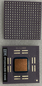

The two ppc604e3db-c400e that i got today are fake, most likely some other speed rating like 300MHz or 250MHz
They are reclaimed, reballed, laser-etched and overpainted. The chips were roughly handled and the silicon is chipped.
I would highly discourage anyone from trying to get these.
The 300MHz rated Motorola chips are most likely the only ones available in decent numbers.

Here are the PPC604e3DB-C400E fakes.
sold by https://impochips.com/ - https://tech-electr.com/
Im pretty sure that they will make any kind of speed rating that you desire :p
